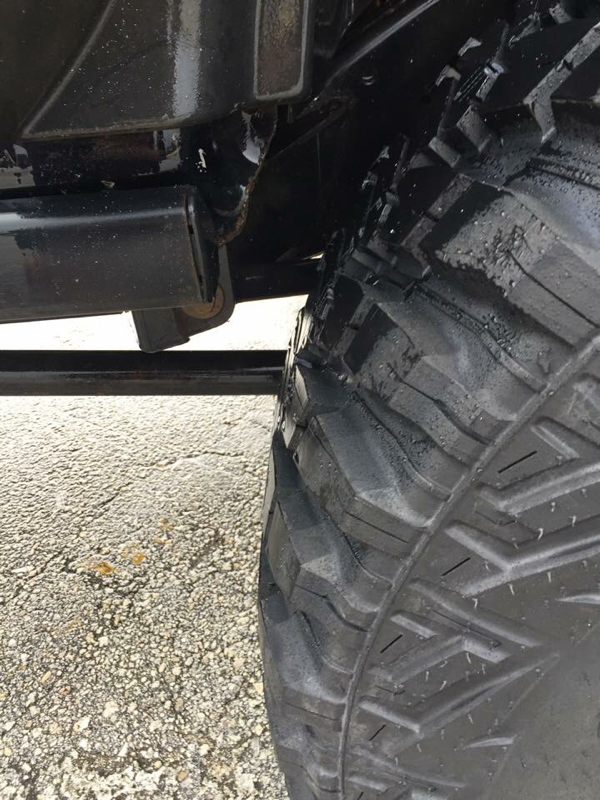

Just put the new shoes on following the dynatrac pro grip brake install, coming from 37 inch super swamper radials, everything was free and clear, rock rails cut and pinch seam trimmed back. Now these 38s seem like I have more work to do. how much more pinch seam can I remove? I have 4.72 inches of backspacing on my pro comps. The new tires are Goodyear wrangler MTRs. The lift is a 6 in TF LCG w Speedbumps. Thanks for any advice.

How about, no one can tell you exactly how much you need to cut. You have to cycle the suspension and check for yourself.

This, exactly. I'll be shocked if you don't have some serious clearance issues in the front with the tires hitting the frame at compression. Even with 3.5" back space and 37" MTRs, my tires hit the frame on both sides and the front grill when turning at full compression.

I think you are going to need some wheel spacers and probably more steering stop at the least, especially if those are the 38x14.5 variety
