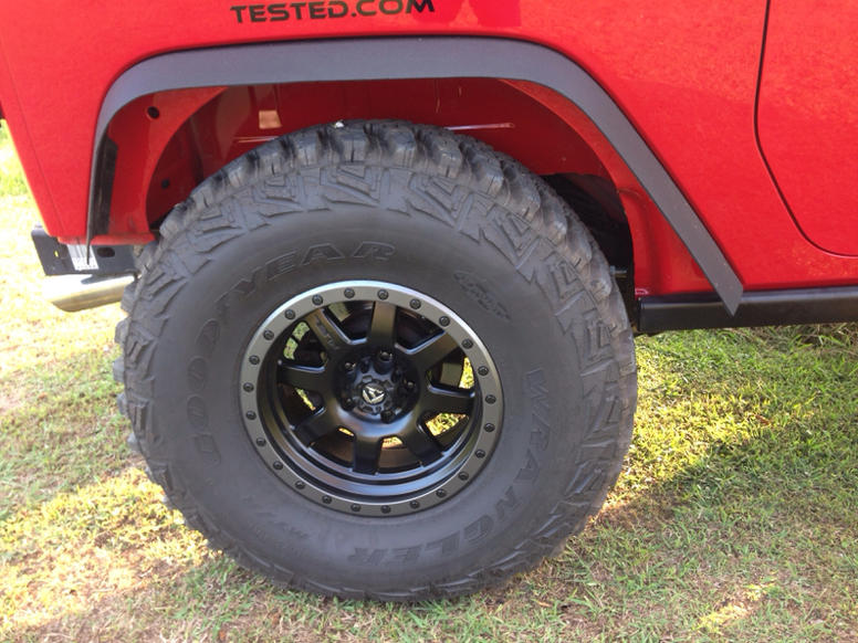

Looks like I'm gonna have to trim behind rear tire to gain maximum flex out of my X factor with 37s. Anyone else have to do this? If so pics please

yup, sounds about right. im only on 35s, but they were close even before i stretched it.
har to see in my pics, heres the before
After:

thanks man. If you get the chance take a close up pic so I can get an idea of how you cut yours.
Old Dec 20, 2013 | 02:17 PM
Maertz's Avatar
Posts: 4,482
From: Neenah, Wisconsin
ill see what i can dig up. mines not super pretty at the moment as I am still debating cutting more off for 37s down the road. I used and angle grinder.

yours seems to be stretched more than mine
Old Dec 20, 2013 | 02:20 PM
Maertz's Avatar
Posts: 4,482
possibly. mines stretched about 3.5" in the rear. only 1" front.
not fully stuffed in this photo, but I shaved down my rear seam a little over an inch. Took about 20 minutes to do both sides with cutting wheel and a flap disk. I run no rear fenders now and you can't tell it was even cut

Heres my crappy cuts so far...Its really thing sheet metal a flap disc will flatten it all out pretty easily.
If i go to 37s i will have to take another inch off.... i had to cut my bottom fender holder off, but you guys shouldnt have to go this crazy.

Heres my crappy cuts so far...Its really thing sheet metal a flap disc will flatten it all out pretty easily. If i go to 37s i will have to take another inch off.... i had to cut my bottom fender holder off, but you guys shouldnt have to go this crazy.
thanks that's what I was looking for. I'm only stretched an inch so I want have to cut a whole lot
