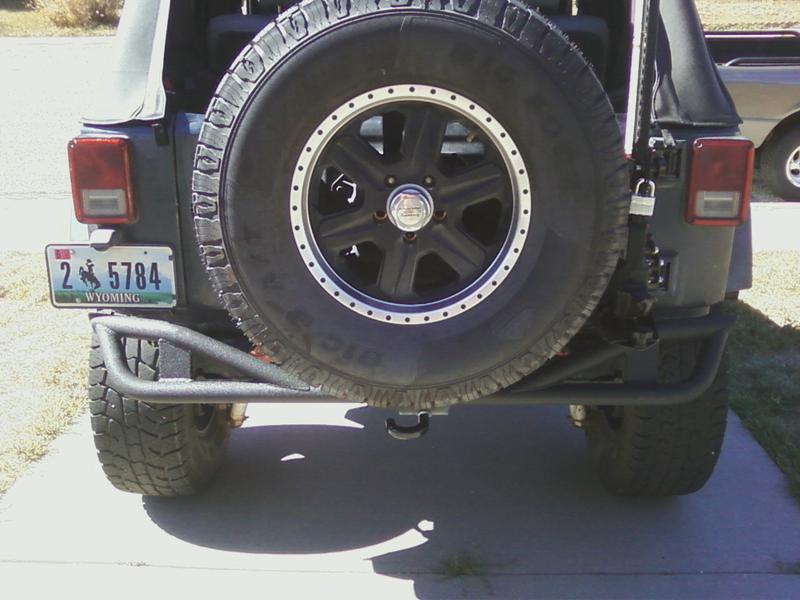

I was wondering how I could attach some dring shackles to the rear of my JK? should I attach them to the bumper or maybe to the frame some how?

The frame is always best, but looking at that bumper your best option would probably be to have a shop weld d-ring tabs on the bumper bracket (the flat part between the tubes).
^^^ My thoughts exactly. don't see any other place that would work without going to the frame!

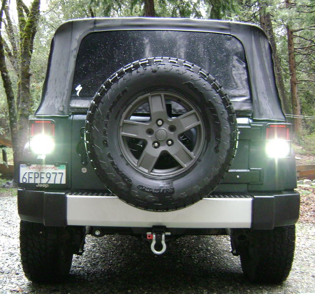

I used a hitch mount clevis/d-ring before I got my new bumper. Worked great!
