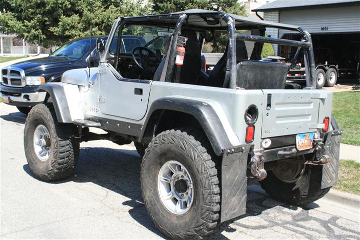

For me, I'm liking the idea of having a kewl JKU that I can cruise around in that's fairly capable but still comfortable to drive 3-5 hours in at speed. I've still got my "hardcore" trail rig for "hardcore" trails. (I have to tow it with my wife's Lincoln as I sold my Cummins to get into the JK but there's always a trade off, right?)
Originally Posted by jkkrawler
Same problem here in PA. But ill figure something out for that lol
RE: the width thing. I still run a stock GM Dana 60 front and stock 14 bolt rear (not cut down for width or anything). Utah state law dictates fender coverage and mud flaps to at least the mid point of the rear tire. Running H2 wheels on my stock 60 and 38" Kevlars, I'm at 82" sidewall to sidewall. With 6" (maybe 7"?) TJ flares I'm street legal in UT. A LOT of TJ or YJ rigs are running at least 80" with their offset wheels. This does create a problem with the locking hub (I've ran drive flanges until last year) being vulnerable to rocks. Yukon just brought a low profile locking hub last summer for 35 spline Dana 60s. They might stick out 1/4" or so more than my drive slugs. I don't run the hard trails much any more anyway.
