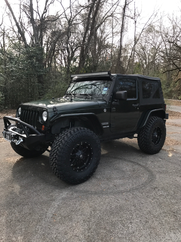

Gears are installed! Rolling on 33" until tomorrow when the 37" come in.
Right now love the gears on these 33".
Here's what everything cost me for those who are thinking of changing gears
$710 for labor
$91.17 Royal Purple fluid
$74.93 front Dana 30 carrier
$639.70 for front and rear 5.13 revolution gears and rebuild kit

Update... now have 37" on and 5.13 gears installed! Been driving for a day now and no limp mode so far!
