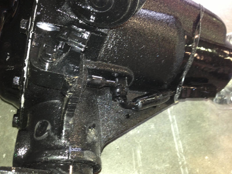

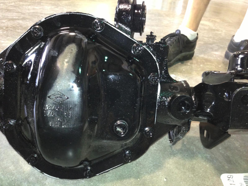

Ok yesterday I went by the body shop to see what had been done to the jeep so far and what parts were in. The new front diff is there. Is a 44 for a rubi. Now one more question. Will the dana 30 axles work with the dana44 carrier?

Dana 44 and Dana 30 parts are not interchangeable. That is a d44 front housing. Are you talking about axle shafts?
