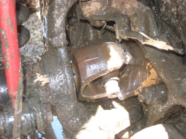

i got a question about some problem on my front dana44
http://nsm01.casimages.com/img/2009/...2033499079.jpg
did some body know what i can do to get my diff more durable?
this picture is from someone else jeep in my jeep club and i dont want to see that hapen on my own jeep.
i plan putting 37'' on it and i dont want to spend big bucks to get a dana60,
so i want to know if i can get my own front diff more stronger

That picture is not of the D44 Diff. That is the axle coming out of it. You could always buy stronger axles for your D44.

A quick search will give loads of threads on upgrade options.
But:
Gears and lockers, alloy shafts, truss, gussets, sleeves. What did I miss?
check here:
https://www.jk-forum.com/forums/show...highlight=cute
- oh yeah, there was something about tack welding the caps on the C's also?

see this thread, Northridge is opening a Canada warehouse. You should get alloy usa axles with ctm u joints, they are both stronger then stock, also get Evo c gussets and control arm skids, you can also add Evo 44mag axle sleeves.

it's not your english per-se, it's more your terminology...when trying to identify vehicle parts the correct name is what allows us to all speak the same language, the pic helps alot though so that's your axle and u-joint
