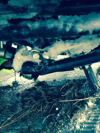

Haha, wheeling hard on 37"s and 44's yeah right.. I rarely leave the parking lot and this is 35's on 44'sClick image for larger version
ID:	600358Click image for larger version

I've seen a few break like that, and I've seen others wheeled reasonably hard (Rubicon, Dusy, etc.) and survive just fine.
