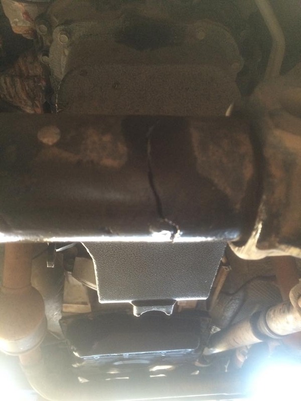

I know I gave my word of caution, but just saw this picture and wanted to reiterate it. While people are not out breaking axles everyday, it can happen, even with the right precautions. Picture attached is of an axle with weld in axle sleeves. Guy was commuting home from work, pulled in the driveway and heard a pop. Came out a bit later to fluid in the driveway and found his axle broken. Good news is that the sleeves prevented more serious damage or even an accident.
Point is, you have to at least understand that you are playing the odds. Good chance it won't happen, but possible that it could. And be mentally prepared for the cost to fix it should it happen. What I have found interesting is the number of broken axles I have been seeing lately that are sleeved or trussed. It helps, but I am starting to question how much it helps. Maybe my local club is an anomaly, but we have a pretty high rate of bent and broken axles. I'd say most of them are not on forums. I've often suggested that there is a lack of data points resulting in a bias view that axle issues are rare. I think most of those data points don't make it to the forums.
<img src="https://www.jk-forum.com/forums/attachment.php?attachmentid=619117"/>
Excellent points. I've seen a few incidents in a non-wheeling situation where tubes have cracked.
One was as simple as a pothole...which here in Michigan are more like caverns. And this was with 33's.
Point is, these are very weak and as Invest stated, for every one you hear of on the forums, probably 4 or 5 others happened.
Makes a full axle swap upgrade all the more appealing
Attachment 619117
Sleeving has become rather "old school" vs the Artec truss & gussets. A bit more work with the Artec mod, as it's bext to remove the axle to do the job, but they've proven to be pretty much the fix of fixes for the dumb@$$ weak front axle tubes.
Sent from my LG-LS980 using JK-Forum
My group is much like everyone here were all running 35", 37" and having good luck so far! But the other night one of my friends saw a stock Sahara sitting beside the highway left wheel bent in long side tube fully broken at the UCA. That sucks and makes me think there may be a lot of flaws in the tubes coming in the JK. There are enough of us lucky folks out there that you would never expect a stocker to crack?
Agree, but.... Haha
