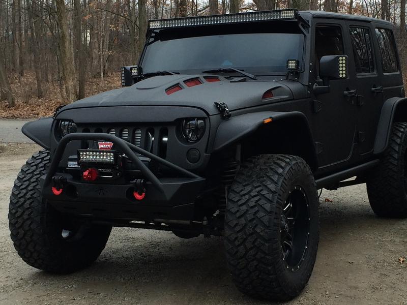

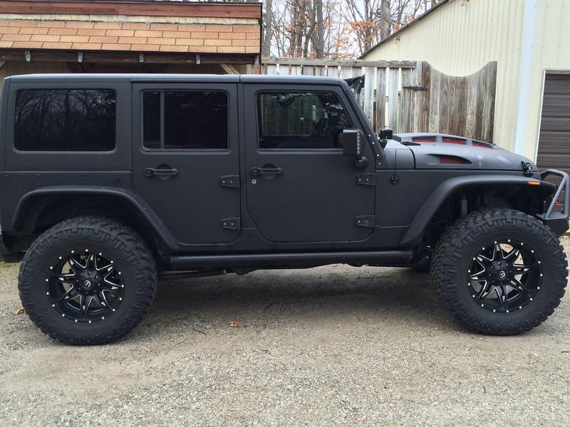

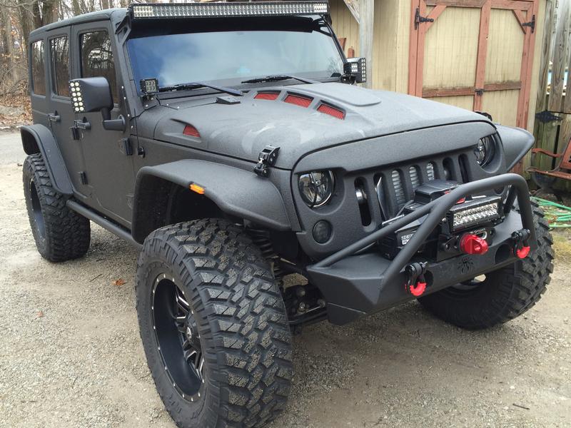

Does anyone know if the Dana 44 is the same width as a Dana 60. I have 37" on 4.5" backspace and am rubbing even with flat fenders and 4" Rough Country longarm.

Good point. i am looking at the G2 Core 44 axles or the G2 pro rock 60. Im not doing too much offroad and I drive a bunch on the highway but would like a good all around setup.

just rubbing on the inner fender on the rear side. It was rubbing on the front but we pushed the axles back. I plan on getting new axle assembly soon front and rear. I need new gearing anyway.

Either way, just trim that thing. Do you have a picture of your rig you can post up?

Anyone running the core 44?
