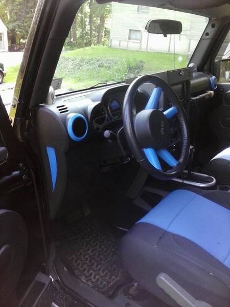

i started painting my interior on sunday but i was sick and stopped before i was done ive researched this already and cant figure it out so one how do i disassemble my dash to get to my readouts and how do i get the bezel around my shifter off please helpClick image for larger version

For the shifter bezel, there's 2 vertical clips on the side closest to cup holders. You pull that side UP, then it slides towards the rear of Jeep. I broke one of my tabs first time because i didn't know to slide it back.
Dash part, can't help ya. Sorry.
PS. Lookin great so far. I've been wanting to do this, but haven't ordered the my color matched paint.

To get the cluster out, there are 2 screws on the top of the dash to remove the black plastic trim that surrounds the gauges. After, you will see four screws on the plastic housing for the actual gauge cluster. Once removed, disconnect wiring clips from the back. Once the cluster is in your hand, you will see that there are clips around the clear plastic to remove it (be careful with these). Then your gauges are exposed and the interior trip piece is loose. Mask off and paint.
