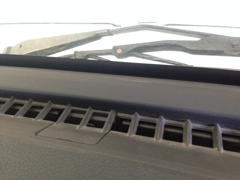

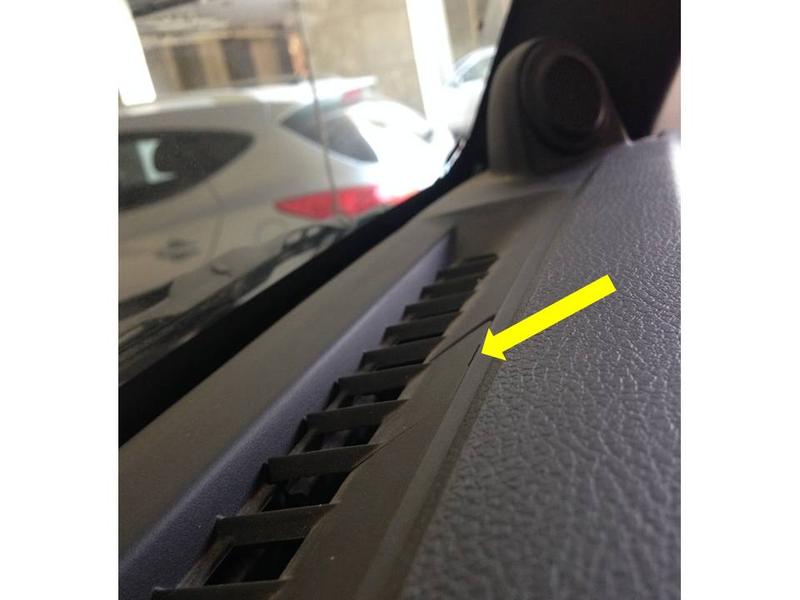

Old May 23, 2014 | 04:27 AM
GJeep's Avatar
Posts: 2,145
From: Israel
Originally Posted by Vector Offroad
They are there, but difficult to find. Jeep did a great job of hiding them on the dash. Search a bit more, and you will be able to locate them.
Yes, Jeep did a great job of hiding them... can't be seen unless you lean forward all the way.
Very obvious, though, with the camera right on top and with light coming from the side -- this must be the tab :

As the connection goes down through the air-conditioner cold air stream, I wonder about condensation dripping down there.
Great, glad you found them. The 07-10 design has had a tab in that location and in use since 2011 when we first rolled the e-dock's out. We have never had any problems with condensation.
