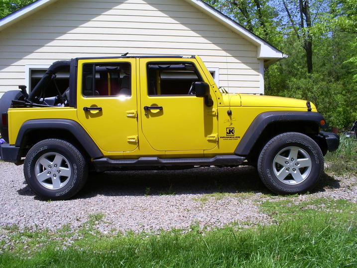

I installed the RE 1.75 spacers in the front, leveled me right up. Anything under 2'' won't require new brake hoses or shocks.
