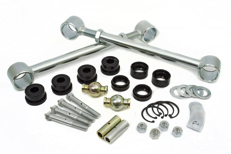

Here's a photo showing how they are constructed. By all means, make sure you get the "poly-flex joint tool (KU70091)". It is really tough to put the joints together properly without the tool. Be sure to ask when you order.
Good luck! PM me if you have specific questions.

Hopefully they aren't chrome like that right??
