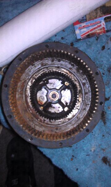

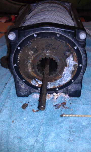

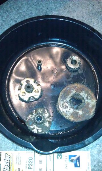

Open it up. This is what I bought for 100 bucks. It didn't work but I just put about 50 bucks into and it works great

Agreed on taking it apart. A winch is just a geared, electric motor. Same concept as like an electric grinder. If you don't need an upgrade and want to save some cash, I'd try and repair it.
