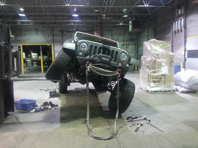

My top stock arms were to short and pulling down on my diff causing my coils to bow out. And the bottoms pulled in. You were right with pitman arm and caster. I installed short arms on the front and lower and removed pitman arm.
Tested out the flex. Even with 6.5 lift. Still rubbing.
