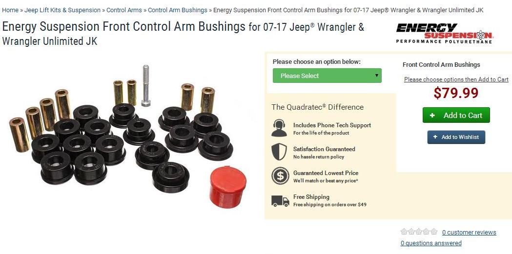

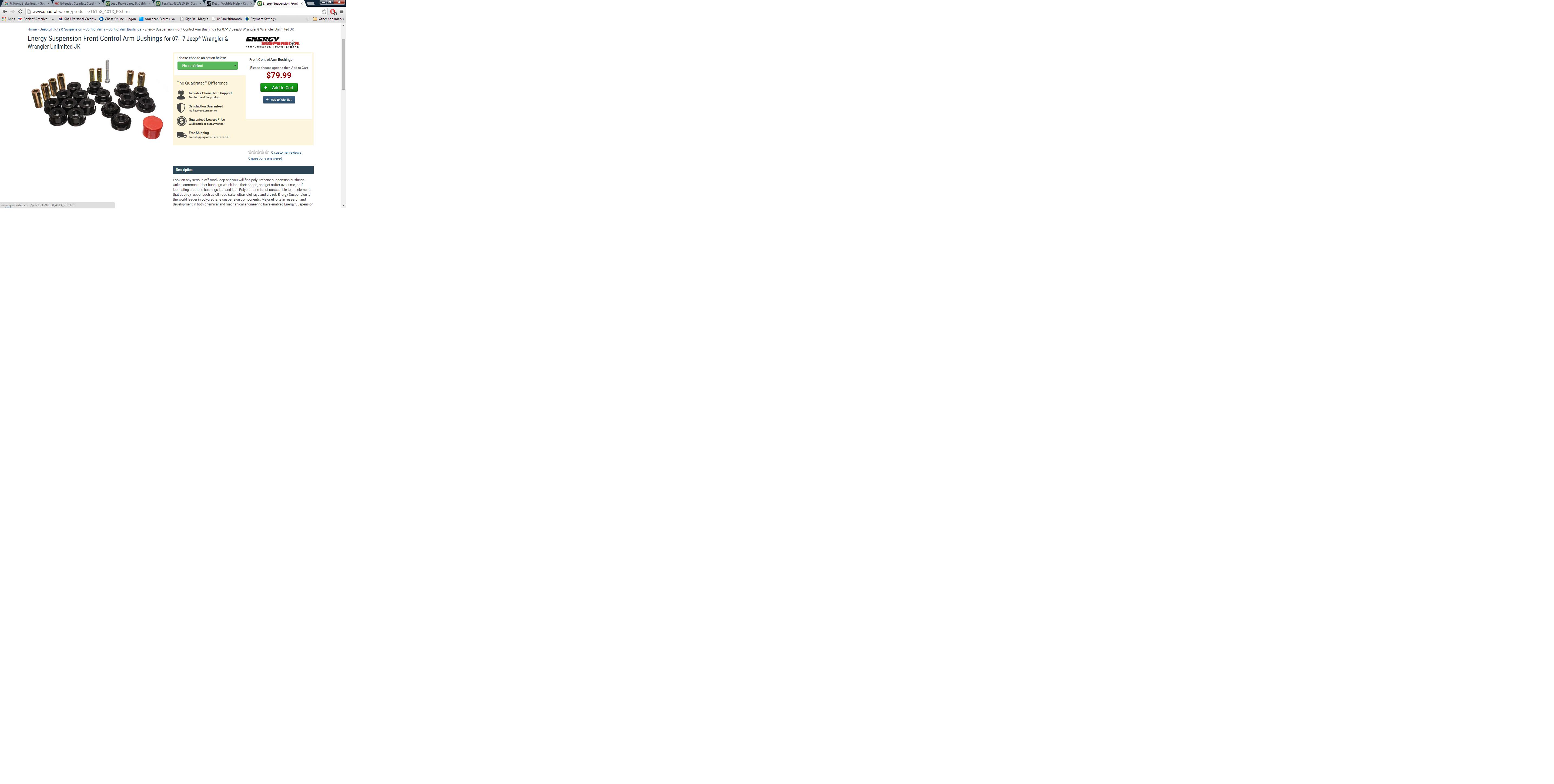

What I did is purchased the Energy Suspension Front Set for the control arms and track bar. I did not know what it was until I started taking parts off and looking at them first hand.
