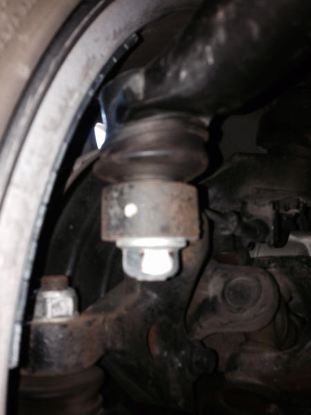

I dont have channel locks to squezee down in the the tie rods or the ends of the drag link. but i did notice this about the drag link end that attaches to the knuckle.
Old Apr 17, 2015 | 07:13 AM
achtung's Avatar
Joined: Feb 2014
Posts: 59
From: Rancho Cucamonga, CA
To those that I have the AEV suspension installed in their Jeep. I noticed this on the drag link side that's connected to the knuckle. It almost seems to me that it needs to go in more that there's not enough thread sticking out the end given it a very tight fit.
I can see evidence of it moving side to side but it wasn't moving up and down like on the video.
It is drilled up properly to the 7/8 diameter required I do have the sleeve in there maybe I should undo it and tap down to see if it will go into the knuckle more.

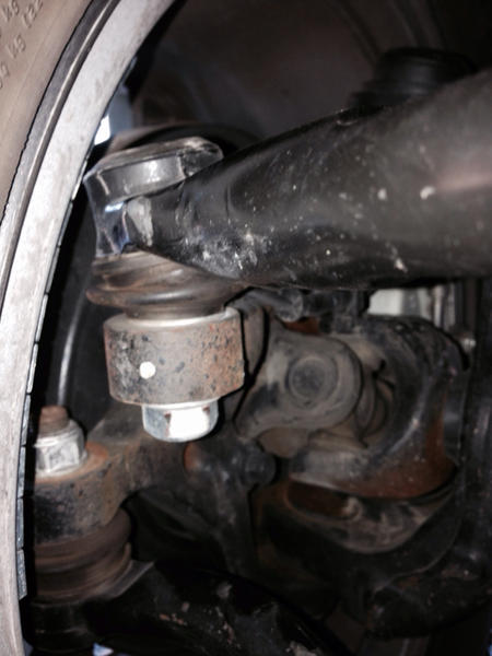

Here is another pic slightly different angle.

Old Apr 17, 2015 | 09:04 PM
CerOf's Avatar
Joined: Apr 2009
Posts: 1,331
From: Dallas, TX
that doesn't seem all the way in. My memory is failing and it's been racing and lightning, so won't him out and look at mine, but I think it is tapered and needs to go in further.
How did you tighten yours? I think you need a 7mm hex/Allen typed tool to hold the top while you turn the nut.

Old Apr 17, 2015 | 09:37 PM
SpicedCrusher's Avatar
Posts: 899
From: Canada
Hard to tell but it doesn't look seated properly and is it bent as well?

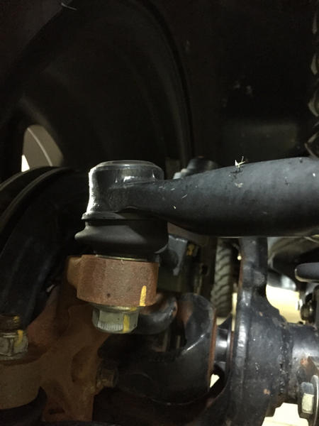

Here is a picture of my drag link flip (AEV). Mine is seated correctly as the knuckle was removed and drilled at a machine shop so I know the hole is exactly 7/8" as the instructions called for.
