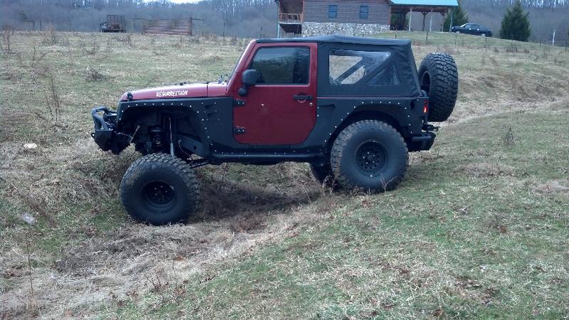

I'm trying to decide between the Rock hard engine, trans skid plate and the Evo three piece setup. I like the clearance of the Evo and the way it covers the cat but I like the one piece design of the Rock Hard( I think it would slide over obstacles better). And it covers the cat also but doesn't look as strong as the Evo. I have a 2013, 2 door 6 speed manual with 2.5" RK lift and 35" KM2'S. I have an aftermarket front drive shaft. I just need a little push in one direction. If you know of a better skid in this price range let me know.
