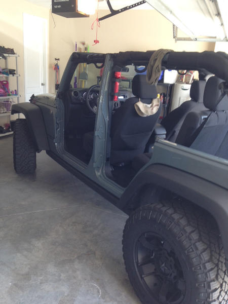

If you go with a wheel that has a 4.5 back spacing you won't need wheel spacers. I have the xd rockstar 2 17x9 with -12 offset and 285/75/r17 tires. No problems with rubbing on completely stock suspension. I think it has a tuff look this way, but every time I am around a lifted one I want to lift mine

The 18x9 with that back spacing would work and you would need a 285/65/R18 tire. That would keep you about a 33 x 11.5 in wide and should be ok with rubbing. Good luck finding what you like
