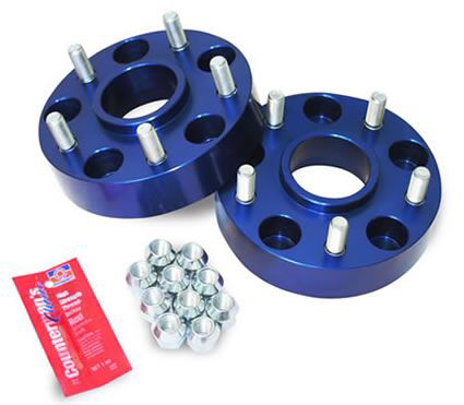

The issue isn't 15" wheel but could be steel vs. alloy. Stamped steel needs the flange for strength or else it would flex. I'm thinking those running 15" steel are using wheel spacers to clear the flange, since the diameter of spacers are less than diameter of rotor. The spacer sits inside the flange of the wheel and makes flush contact. Only way to test theory is for other 15" steel wheel jeepers pipe in with pictures and details.
Yeah, I'm curious as I've heard from lots of people that they don't make spacers with this small of a diameter. There are folks running pro comps and I think they are both made at the same place.

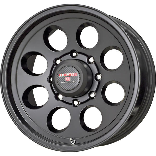

I know it's not the answer your looking for, but it is a $500 fix that uses your current tires. Alloy instead of steel.
Thanks! I like the trackers and I also like the MB razors, I just feel like I need a fake beadlock around the lip to break up all the black. If I can't get info on the procomps that folks are running, I'm probably going to go with the razors. I may even have summit ship me just one of the procomp rims and fit check it. I'll lose 30 bucks on return shipping, but at least I won't have to do anymore research haha.
