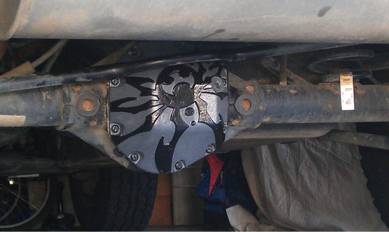

I always us vinegar to remove any oil from the metal. Then dry with a towel and prime shortly after. If you did get some rust you could always use the primer that is meant to be used over rust. I did my PSC cover last year and it still looks great. Once you remove the oil with the vinegar bare metal will rust right away, especial if water is evolved. Even your finger prints will cause rust. Here is a picture of mine. I do wish I had reversed the colors.
