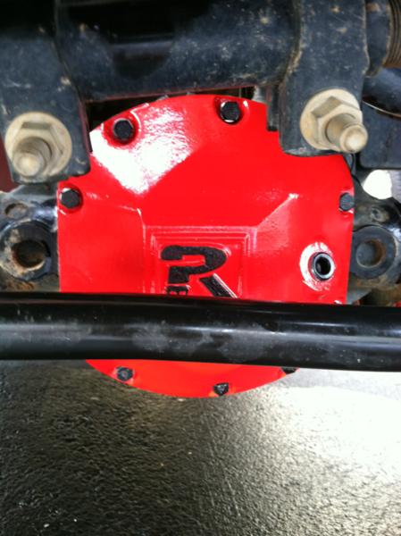

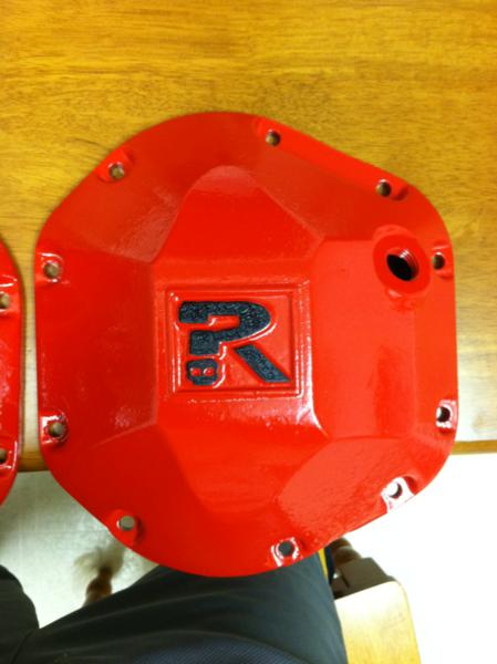

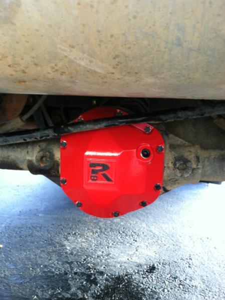

I have riddler covers. Take the time to paint them to your liking!

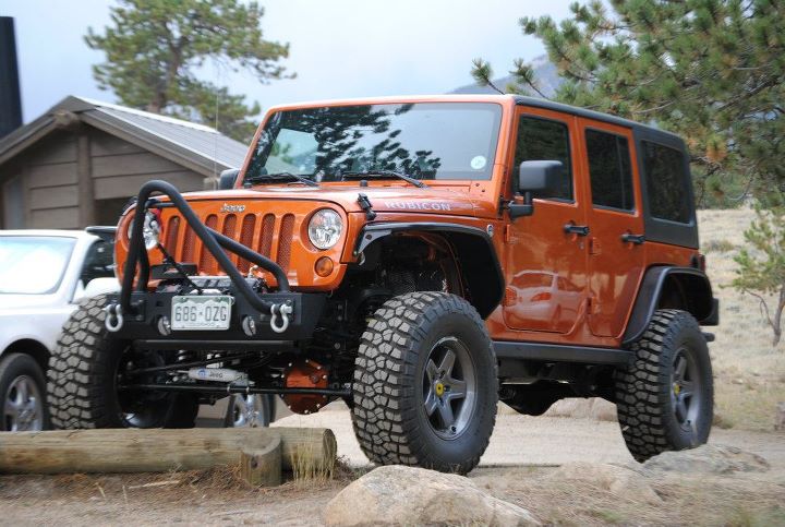

I have a Mango Tango like yours so I just got some color matching paint and hit them up with the garage door open, put a space heater on them with the garage door closed for a few hours and voila, done. Easy peasy!
You can see a pic of how mine matches up well with the Jeep. Oh and i got the Riddlers too. You can also see where I did the grille mesh mod and painted that Mango Tango too when doing the diff covers.
