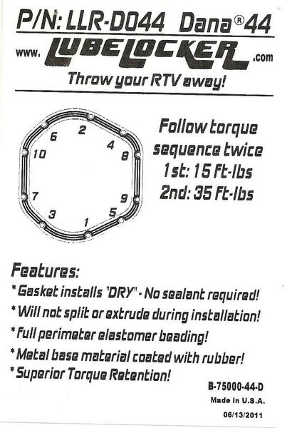

Originally Posted by ronin2120
When installing the lube lockers I am assuming you should tighten the bolts down in a star pattern but how tight should the bolts be tightened down to?
Yes, you are right! Just for this little job it is worth to buy a torque wrench, if you don't have one. You can't just "play it by ear" or touch rather LOL. These specs are mission critical!
First round = 15 lbs, second round = 35 lbs; plugs 35 lbs.Click image for larger version

Haven't people had problems breaking bolts trying to torque to 35ft/lbs?
Old Jun 9, 2012 | 07:53 AM
  #25
eumel789's Avatar
Posts: 491
From: Boynton Beach, FL
Have you looked at the size of the bolts? No way if they used a torque wrench!
