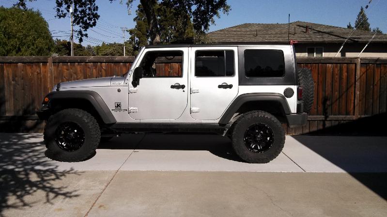

One thing about teraflex is you can always up grade. I started with a leveling kit and moved up to a 2.5 coil lift and kept the one inch spacer on for a total of 3 inches.
I also have a 10 k wench up front and a 34" toyo mt on the back tire alone weighs 97 pounds.
