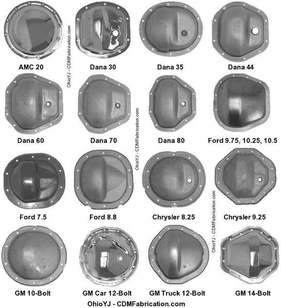

How do I know what I have? I'd like to have one of those red ARB covers but I'm not sure what I have for rear and front differentials. Sorry, kind of a newbie when it comes to this. Is there a way to tell by looking at them?

If you have a Sahara or lower trim model d30 front and d44 rear.
Run icons have d44 front and rear

Yeah, mine is a 2007 Unlimited X with 4.10 gears. So D30's on front and D44 on back, huh?

In 07 you could have a Dana 35 rear

Yes only in 07 did they have the crummy d35, they also made a 2wd version but not only in 07 and 08-up all had d44's

Use this.
