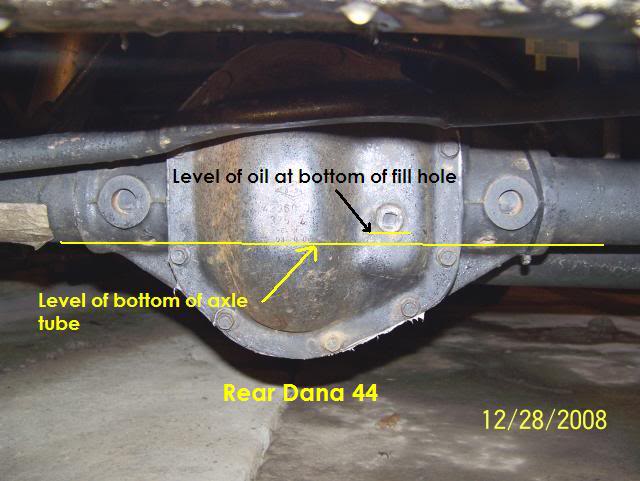

The fill amount would be the same as factory spec. Everyone's full mark with a modified Jeep is going to be different, depends on height of lift. So the full line on the dipstick is going to be different. Best way to be sure you have the correct amount of gear oil is to measure it going in and then make a mark for future reference.
Front Differential Capacity:
2.7 pints (1.35 quarts)
Rear Differential Capacity:
4.75 pints (2.375 quarts)

Putting a number on the quantity is pointless.
Go by the great picture above to ensure there is enough oil to bring it above the bottom of the axle tube. This will allow the oil to get to the outer axle bearings.
Same level applies to the front, too.

The higher the lift, the more the axle may rotate, making the stock fill plug lower.
To ensure the proper fill for almost any situation, see the photograph above, and the post right after it.

It's good that they include the dip stick, clearly marked.
But the owner should also know why the oil needs to be at a certain level, so he can double check what the dip stick is indicating on his particular vehicle. Being a little above the bottom of the inside of the axle tube takes precedence over a quantity number, or the mark on a dip stick.
