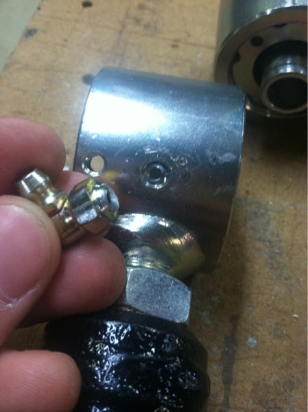

Well.... I go to assemble all the arms, everythings going smoothly, 3 upper arms down on the last one screwing the zerk fitting in and guess what? The zerk completely falls apart!
So let me tell you how thrilled i am rite now!!! Guess the lift is getting postponed another month now....

Just get a small screw driver and back out the busted piece. Zerks are cheap. Yes shouldn't have happened that easy but also an easy fix. Might want to get a few spares you'll probably break another one at some point.

Why would this postpone you a month? back out the broken one and put in a new one. That's an easy fix.

A zerk fitting does not need to be super tight. When you put it on just tighten it until it is snug.

It reall wasnt even that tight i was using a standard 3/8 wrench, a tiny tiny wrench lol its like 5" long....

All is good now..... Tried a snapon easy out, that broke... Kinda pissed about that, drilled the zerk out and used a 1/4" 28 tap and got her out.
