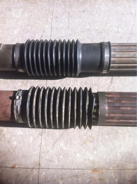

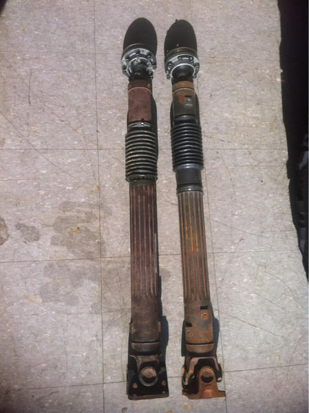

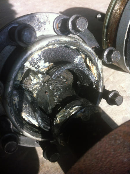

Ran a budget for a little while with the same set-up with the shock extenders and then I got longer Terraflex shocks and I promptly went through 2 stock shafts from too much flex. Have upgraded to 3" coils and an Adams driveshaft since then so I don't have the flex issues anymore so its good that you are taking the time to check everything.
Here is a pic of the first one I broke back in the day and how I did it.
