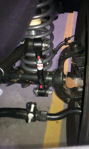

Originally Posted by BlackdogJK
Any sway bar disconnects you would recommend for a 2012 sport?
running jks quicker disconeects on my '12 sport. they are awesome. they have a set for 0-2" lift and 2.5"-6" or something. so the issue is if u are not lifted YET and plan on lifting u will need a new set later. they install easily and disco smoothly.Click image for larger version
