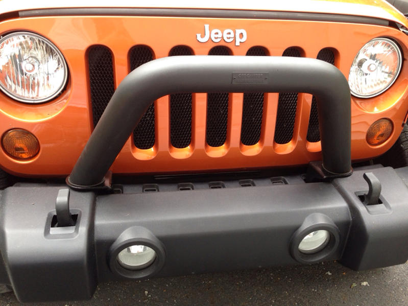

stagedtrip's Avatar
Posts: 3,641
Likes: 10
From: idaho
I used 3/8 perforated steel. I like it cause it goes along with the round headlights parking lights, took the plasti dip off the headlights since then

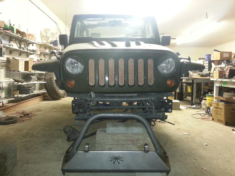

hornetman's Avatar
Veteran: Navy
Posts: 479
Likes: 35
From: St. Johns, FL
I bought my metal ones at home depot two years ago and they have been holding up pretty well. Just make sure that you bond the little plastic squares really good to the grill, scuff sand both the squares and the grill. Also make sure you remove the sticky adhesive on the squares if you use them, if you don't remove the adhesive you will be sorry and have to go back and do the job a second time...first hand experience! I think I used like 16 squares per screen, primed and painted them, and look great! GL with your mod!

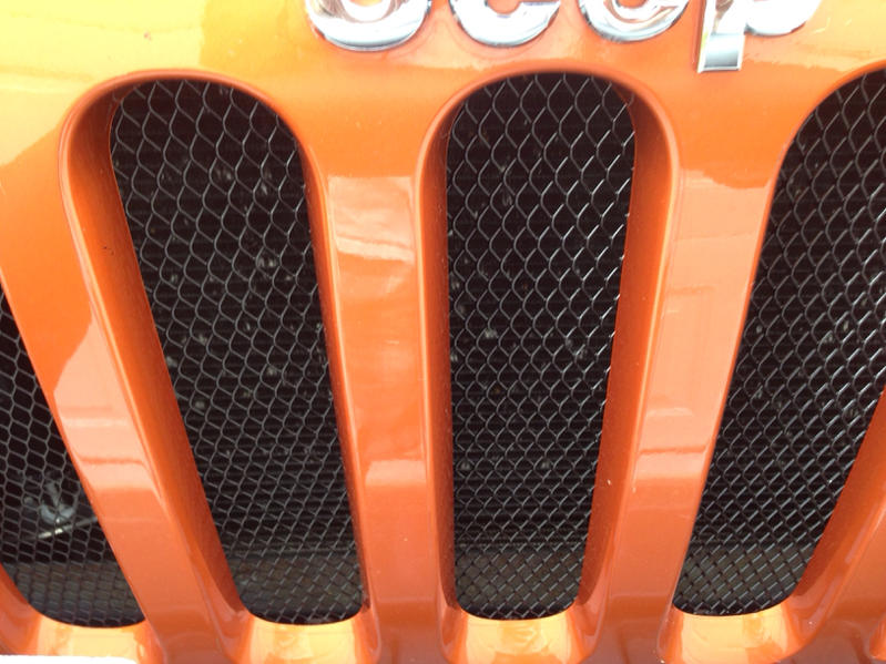

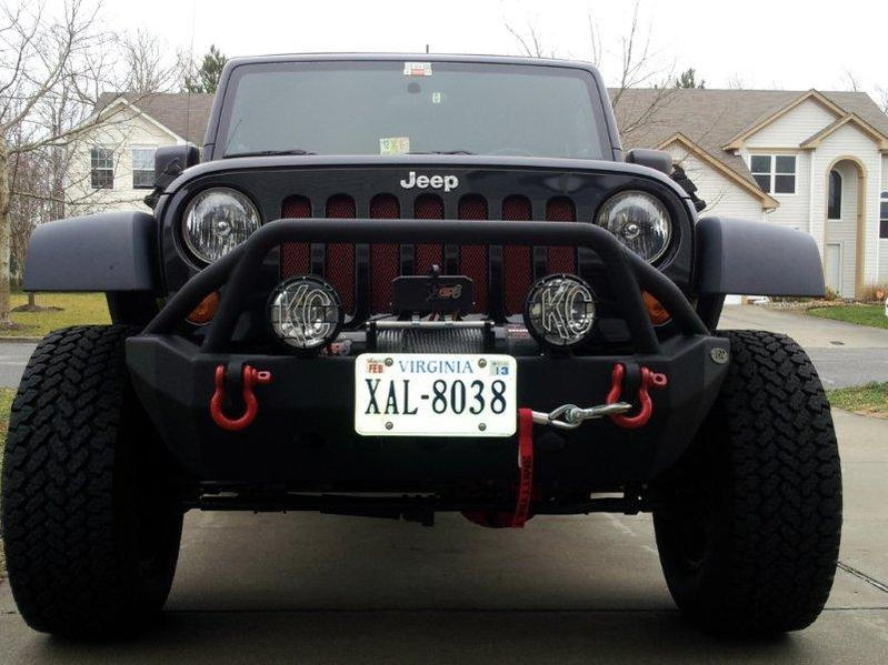

htm7765's Avatar
Joined: Jul 2014
Posts: 455
From: Bluffton SC
Did mine with metal was a little harder than using plastic but I believe the end result is better. Like everyone says glue the tie strap blocks in place otherwise you will be taking off the grille again, I used 2 epoxy
ID:	571125   Click image for larger version
