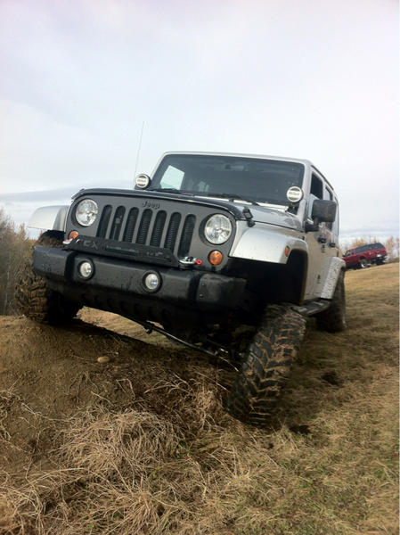

I've ran the Teraflex BB for about 6 months now with my 33" it's a perfect combo. Full flex no rub. One issue is that my front axel is off center from not having an adjustable track bar. I plan to upgrade to rock krawler 2.5" spring front and back and their adjustable front track bar.
My opinion, the BB is a great stepping stone. Lifts you safely with bump stops and rear bracket. An gives you a great base to upgrade to coils.
