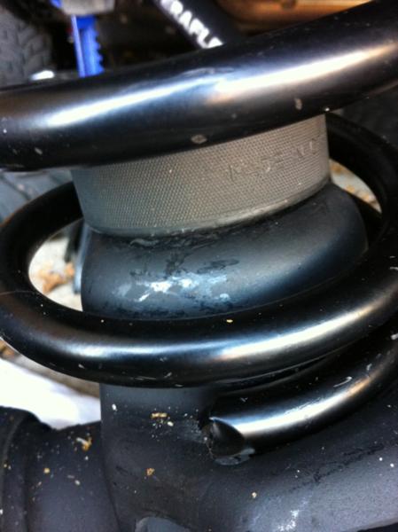

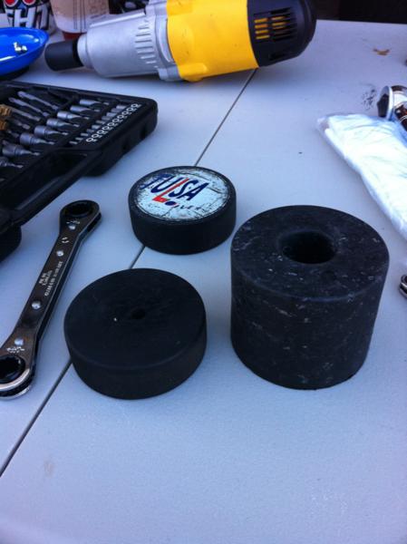

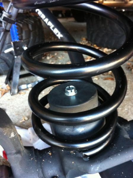

I did hockey pucks on mine instead of the huge plastic puck for bump stops. It was easier to get through the springs too. I might add other puck but we will see. I play hockey so it was a nice little add on for me !!!

Interesting. How did you attach the hockey pucks? Did you have to drill and tap? I will do a search, but that is interesting.
Old Dec 17, 2010 | 01:55 PM
rinkishJK's Avatar
Joined: Jul 2009
Posts: 4,038
From: NORTH JERSEY
I attached mine with a 5 min epoxy.. I like his bolt idea.. Mine haven't and aren't goin anywhere!!! There def on there.. The epoxy I use is for bonding dissimilar materials, such as rubber and metal.
Old Dec 17, 2010 | 04:03 PM
SilverJK12's Avatar
Joined: Apr 2009
Posts: 1,139
From: Tulsa, OK
Drilled a whole then use the self threading bolt that came with the kit. Really easy and gave my jk a hockey touch! :-)
