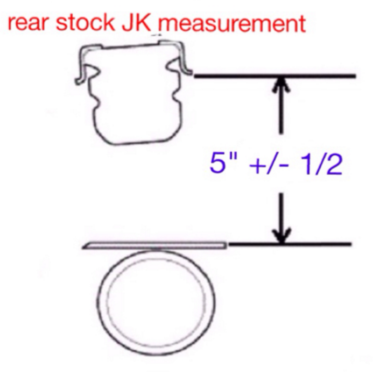

Maybe a really dumb question, but here it goes, the measurements posted above, are they the same front and rear?
No, the rear is a different measurement. I THINK stock is 5" +/- 1/2" like below. I don't know if this is accurate as I've only seen it once and have yet to go measure a factory JK.
