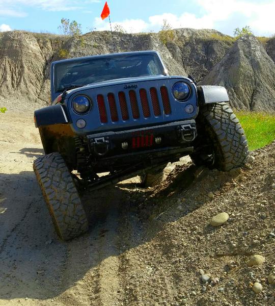

I got 2014 Auto JKU 3.73, with 2.5" AEV AND 315/70/17 Duratrac. Love it on the road and off road!
