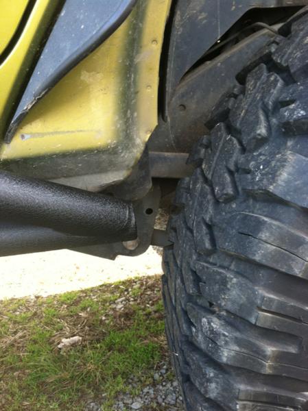

This is the problem I'm having the tire is getting into the rocker guard
Old Feb 13, 2012 | 10:14 AM
nthinuf's Avatar
Posts: 11,463
Likes: 165
Chop it some more, add more bumpstop, or add both sets of arms to move the axle.
