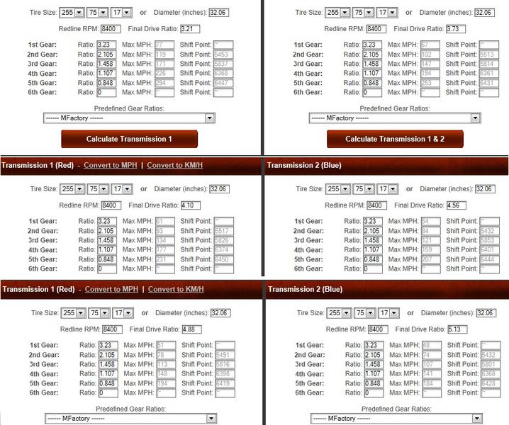

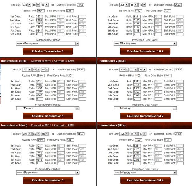

Theoretical gear speeds given final gear size and tire size (32 & 35's)
Im hoping this will end the arguing.
32 Inch Tires
35 Inch Tires
Name:	321 373 410 456 488 513 with 35inch Tires.jpg

32 Inch Tires
Attachment 366895
35 Inch Tires
Attachment 366896
Basically for a 2012 going from 32's to 35's is the same as reducing your gear size 1 whole gear.
For example, 35's with 410 is almost the same as 373 with 32's.
Exactly.......
