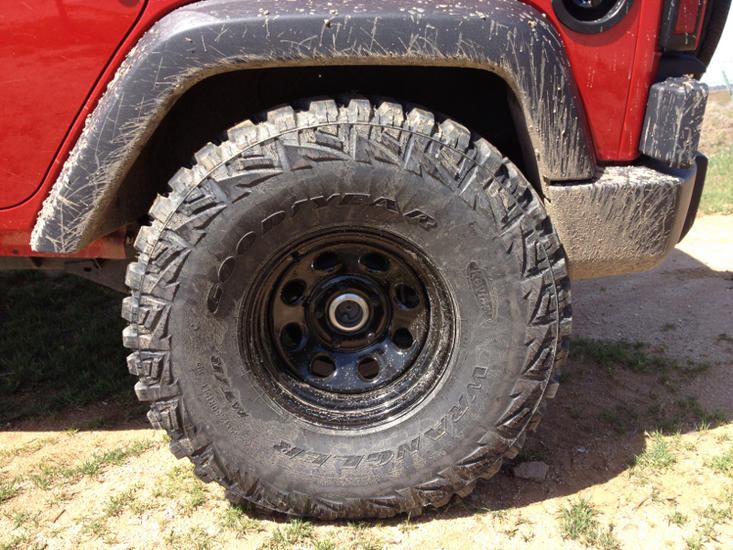

The angle on your front drive shaft won't be that bad sitting at regular ride height, it will be fine for a while if you don't want to do I at time of lift.
I've been running and have wheeled the 3.5 X-Factor on my 2012 for the past year with a still stock drive shaft and haven't had any issues yet, haven't even put a mark on the boot.
A lot of people will tell you to trim the rear pinch seam. The 3.5 X-Factor pushes your rear axle back 1". I'd let it flex before trimming, my 35" tires have plenty of room and it looks like 37"s will fit.
Just make sure you get your bump stop length correct or your stock bumpers will be your limiting factor
Attachment 403421
Good first-hand info to know, thanks!
Attachment 403421
Thanks man. That is very useful information. I appreciate the pic, too.
