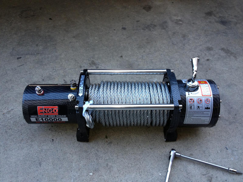

I just got this one for $350 shipped. Engo e10000. Now we have to try and fit it into the AEV bumper with the winch plate AEV makes. We'll see how it goes.
