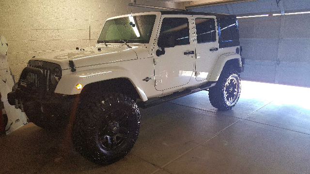

I have the 2.5" AEV with the geo brackets it rides nice on road, performs well off-road. I have about 1500 miles on it so far and 1 off-road trip (soon to be two starting in about an hour). I don't have 35's yet but plan on it by winter. Liked the AEV so much my brother installed it on his JKR last weekend. He put on the 35" BFG KO2's. Loves the set up. Hope this helps. I hear AEV and OME are both great on road and decent off road.
