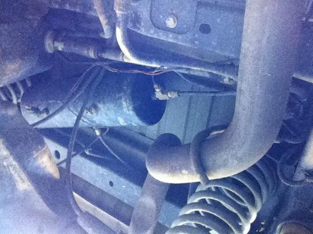

I understand that the Dominion setup uses one of the Viair's on board air system. It's a nice setup and idea if you can afford it. I also debated the need, or not, of a tank for a while and decided to get a Viair system instead of the Dominion. The tank will definitely help inflating the tires faster and even allow for running other accessories.
My plan, right now, is to install the tank and compressor on my Or-Fab tire and gas can carrier. Plenty space for them over there and will not be as exposed as if mounted under the Jeep, even though there are a couple skid plates available to protect the tank. So, under the Jeep is still an idea I am considering. The reason I did not go with the Dominion's concept was because you need to remove the tank to service the belts or anything in that area.
One question about this photo. Is that some kind of paint or corrosion? The tank looks rusted.

Under the Jeep. Some vendors make skid plates that protect the tank there. And I saw a few folks with a high lift doing it without the plate.
