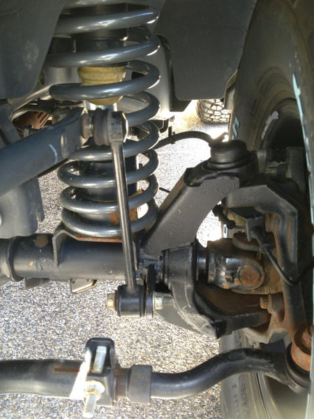

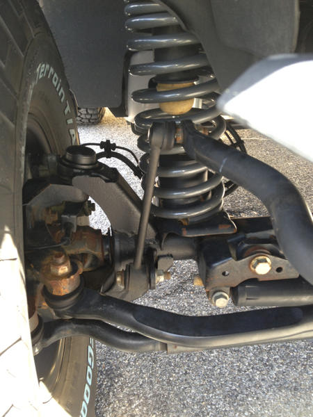

So my jk been pulling to the right lately and noticed this today. Look at these 2 pictures and see if I'm crazy or not...

On the first photo, it's my passenger side the sway bar connect looks like it's on the wrong side of the bracket on the bottom (it's outside toward the wheel)
The second photo is my driver side and the link is straight and on the bracket INSIDE of the wheel.
The other side looks like it's bending badly? Is that normal?

Not sure if this is the cause of the pull but your correct, that passenger side link should be bolted to the inside. Switch it around and see what happens.

Yeah you should fix the crooked one

Ignore my last post, just switch ot around itll take care of it

Also check to see if your axle is centered. From here it looks like the passenger coil might be askew.

The one is clearly wrong. It being on the wrong side will not make the vehicle pull in any way though.
