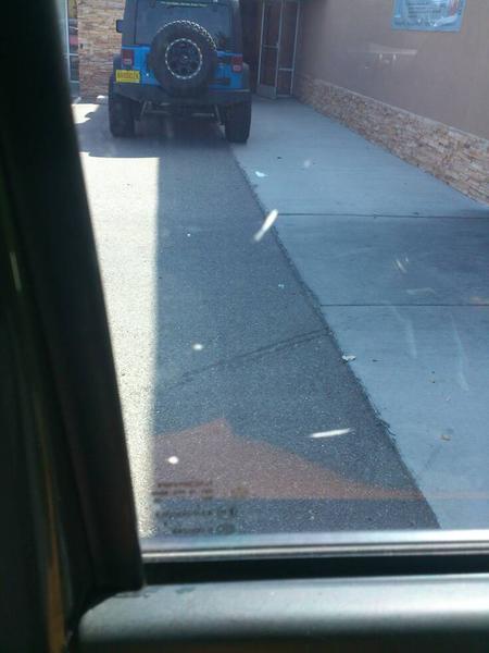

These are the scratches on the inside of the window. Happens on all JKs.

Old Oct 15, 2013 | 05:38 PM
Ncb's Avatar
Ncb
Posts: 1,087
From: Parker, Colorado
I don't have that on my JK after five years. Maybe there's a badger living inside your door.
Old Oct 16, 2013 | 06:15 PM
ballsdeep's Avatar
Posts: 390
From: Albuquerque, NM
That's my uncles jk, same on mine, same on my other one. I've seen it on a number of customers vehicles also.
