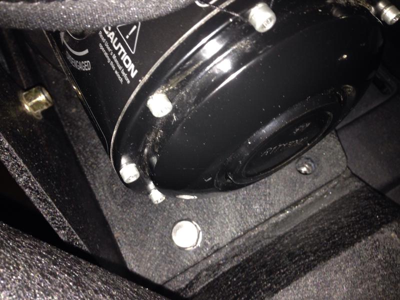

I'm not sure we are all following which bolt. To the plate and frame or the plate and winch?
Post a pic OP.
Thanks

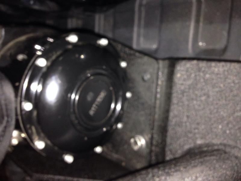

Sorry for the delay. But it's the bolts to mount the winch plate to bumper. The winch is already attached to winch plate.

That is one of those setups where you tap the frame?

the winch is bolted to the winch plate. then the winch plate is bolted to the bumper only. the bumper is attached to the frame

So the bolt we can see at the front, won't back off now? If so, get a big pry bar and shove it between the plate and the bumper and get someone to now up on it while you try to remove the nut. An air or electric impact will prob be your only hope. You need pressure on the back of te nut though and I don't see another way of doing that than prying the plate and bumper apart. It shouldn't hurt anything as long as you are careful.

No, it's the rear empty spot. I was finally able to back the bolt out but now when I try to install a bolt, it only goes in half way and stops. I think because when I forced it earlier, it was going in at a slight angle due to the round gear box just slightly being in the way
