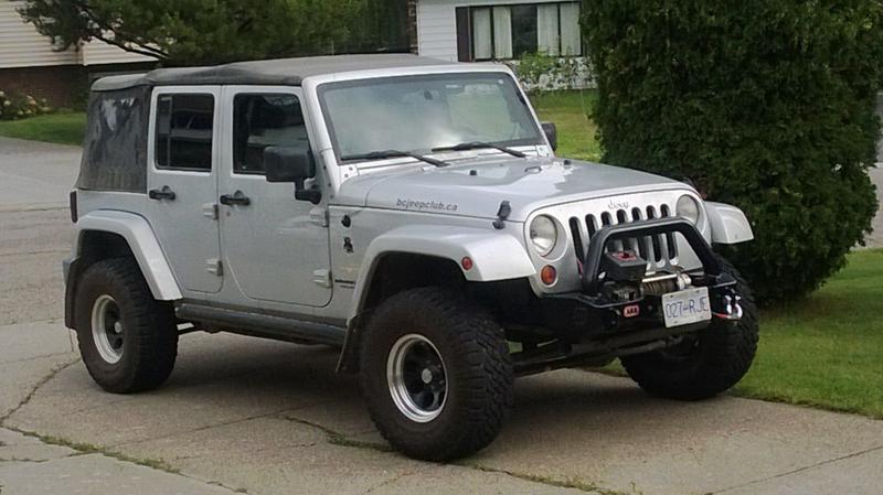

Re-gear to what? - he's already running 5.13s. So if he goes to 33's he might need to re-gear also back to 4.10's or 4.56? I run 33's with 3.21's and it's not neck-snapping, but it's not a dog either since the actual diameter is smaller than 33.
Totally agree that the look is good if you have the correct offset!
Here's mine with 33's:

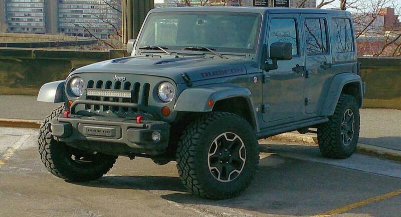

here's mine with 33s also ( 285/70r17 Duratracs)
