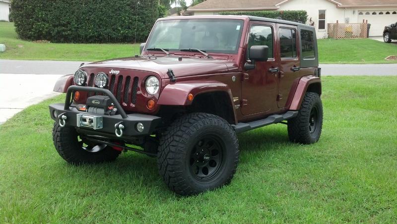

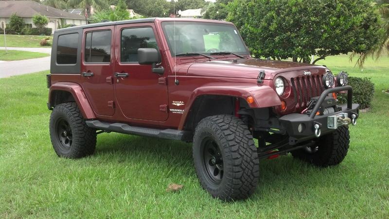

I have a 4" Rancho Sport Lift with drop pitman arm and drop track bar bracket. They were engineered to work together from the get-go. My steering has always been solid.
