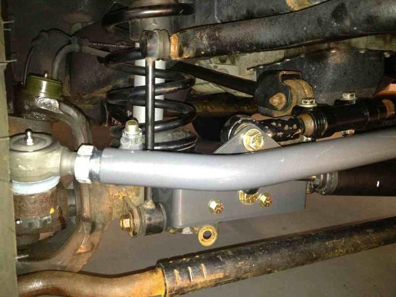

Synergy Click image for larger version

Just installed synergy setup last weekend, works great and drag link and ends are great quality and greaseable at both ends.

Originally Posted by aaronstephen
Does the synergy kit come with a relocation bracket for the steering stabilizer?
There's 2 holes to mount the SS.
If using a fox, synergy makes a brackets that mounts to the same 3 bolts that secure the TB mount.

Originally Posted by kjeeper10
Synergy <img src="https://www.jk-forum.com/forums/attachment.php?attachmentid=441227"/>
The jam nut on your drag link needs to be tightened.
Not a jam nut. Synergy uses threaded sleeves with a pinch bolt. That way you can adjust without disco'ing the tie rod end.
