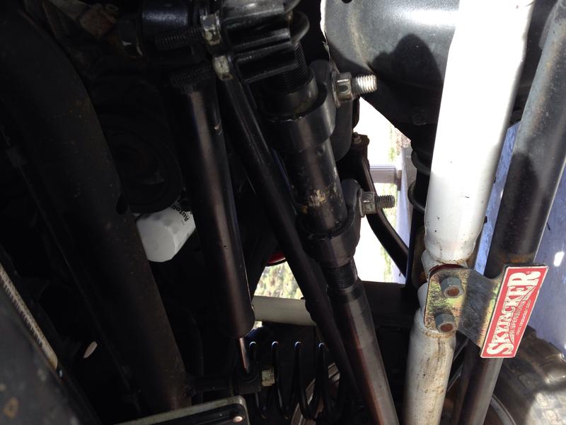

I have a dual SS. But attached to my stock dl is a dampner also. Maybe I need to take a pic of it

This is it. It's attached to my drag link. I'm thinking I won't need it after I install a DLFK. Click image for larger version

Wow never seen that before

You don't need it now. I have never seen that before...dual stabilizers on the tie rod and another one on the drag link, that is a really weird combo.

Kinda what I was thinking. I was pretty sure I wouldn't need it plus I have never seen this set up before.

Find a stock tie rod mount. Most track bar mounts have a hole for The SS.
