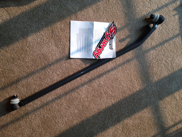

WOW! All I can say is I am shocked at how beefy this thing is. I can't imagine I will ever have an issue with this part again! Now I just need to decide if I install in stock position or flip it. I only have a 2.5" lift.

Originally Posted by 46chevytruck
WOW! All I can say is I am shocked at how beefy this thing is. I can't imagine I will ever have an issue with this part again! Now I just need to decide if I install in stock position or flip it. I only have a 2.5" lift. <img src="https://www.jk-forum.com/forums/attachment.php?attachmentid=565888"/>
You'll need three inches of bump stop which is a lot for a 2.5" lift. Plus a bracket to raise the axle side track bar end.
Stock. Don't flip it. No need to
Stock side it is. Thanks for the input. I guess I'm all set if I ever want to put a larger lift and 40's on.
