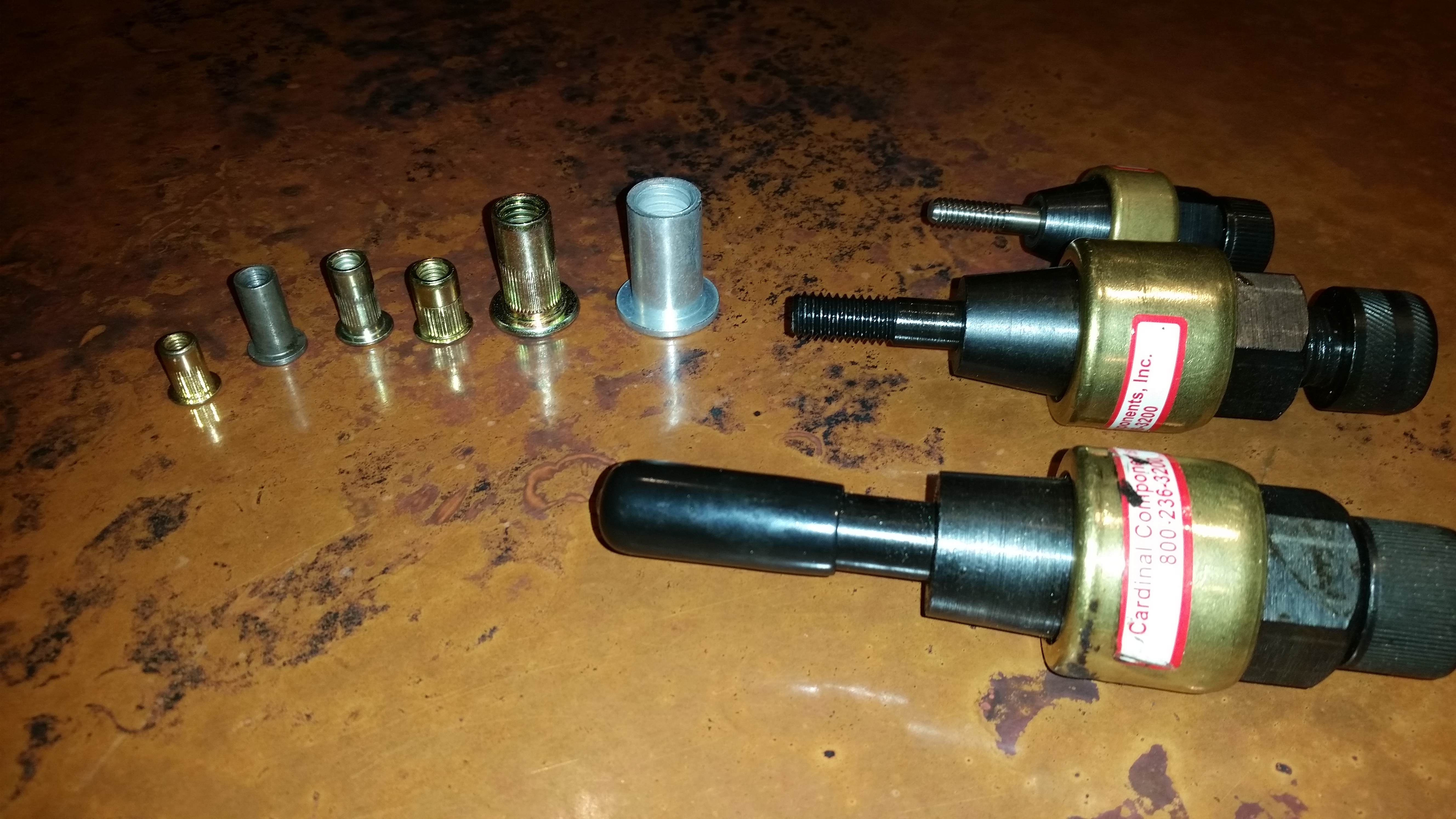

Here is some general information:
Finally I want to show that if you have an assortment of RIVNUT's you will get a lot of use out of them. Often I have been in a situation where it was just going to be a pain in the butt to get a nut on the back of a bolt, so instead I used a RIVNUT and made the whole situation easier. I use this set of RIVNUTS more often than my tap and dies, more often than my air hammer, more often than a pipe bender, more than a bearing puller, a pickle fork, a hole punch... Yet almost all of those tools cost more then the RIVNUT install tool.
Photo above, left to right.
10-32, Zinc coated Steel, Knurled, panel thickness = .062"
1/4"-20, Stainless Steel, panel thickness = 1/8"
1/4"-20, Zinc coated Steel, Knurled, panel thickness = 1/8"
M8, Zinc coated Steel, Knurled, panel thickness = .062"
3/8"-16, Zinc coated Steel, Knurled, panel thickness = 1/8"
1/2"-13, Zinc coated Steel, panel thickness = 1/4"
3 different size tools.

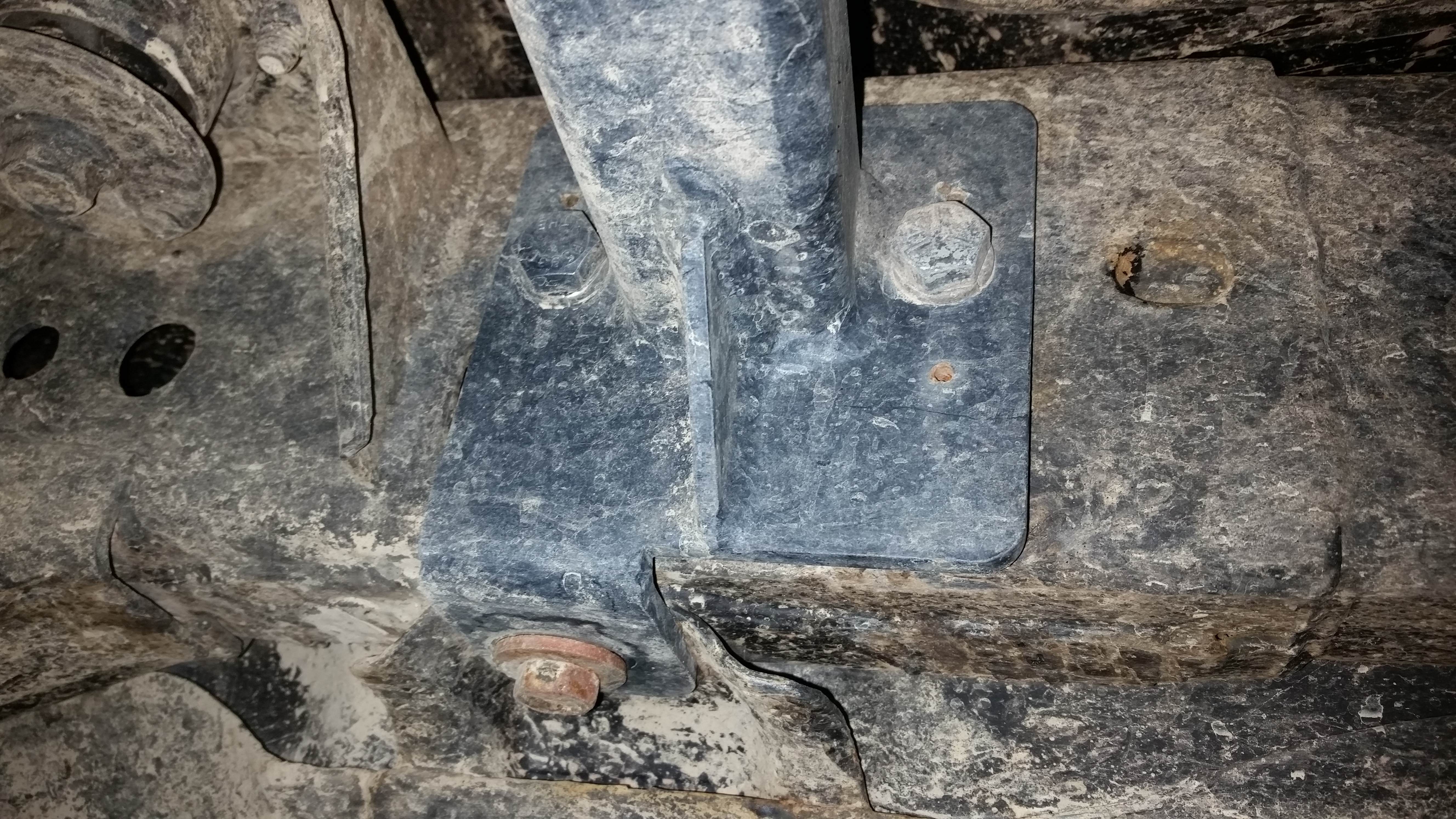

Rear corners from AEV are held on by them.
LOD rock sliders are held to the frame with them. 1/2" one's that are installed in the frame sidewall.

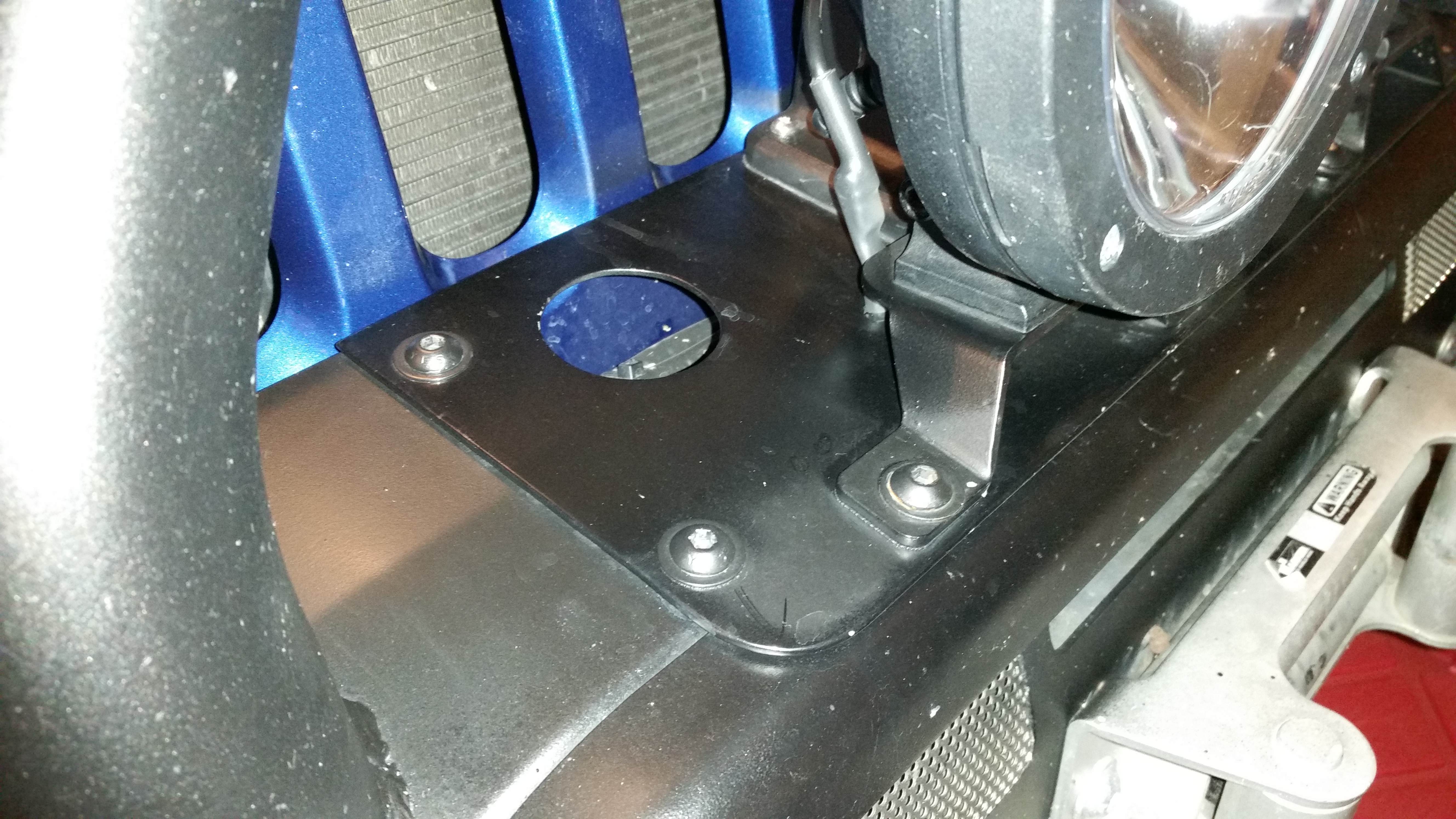

Bumper mounted lights and the AEV winch delete plate are held on with them.
The light bar above the window is held to the bracket with them.

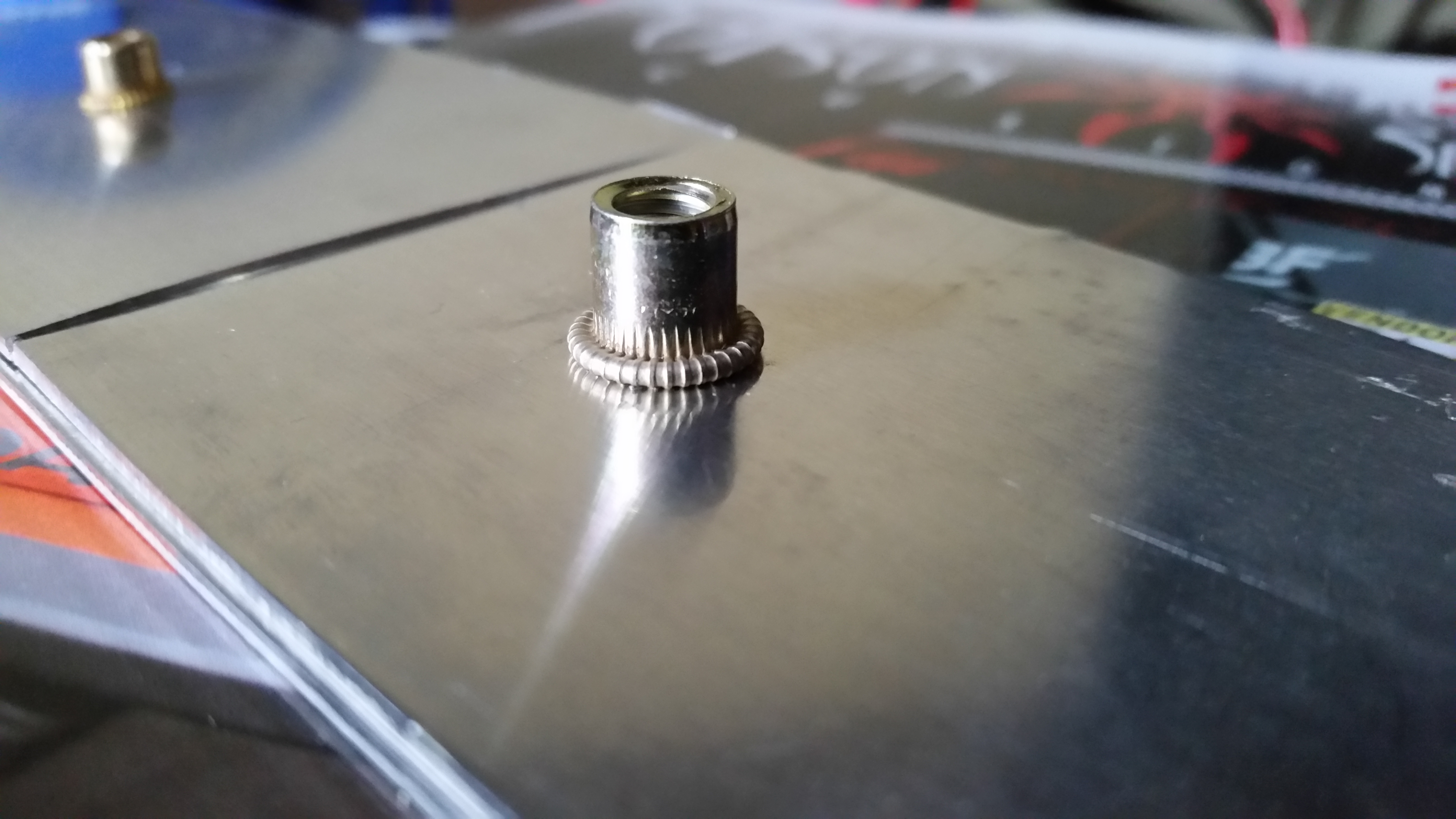

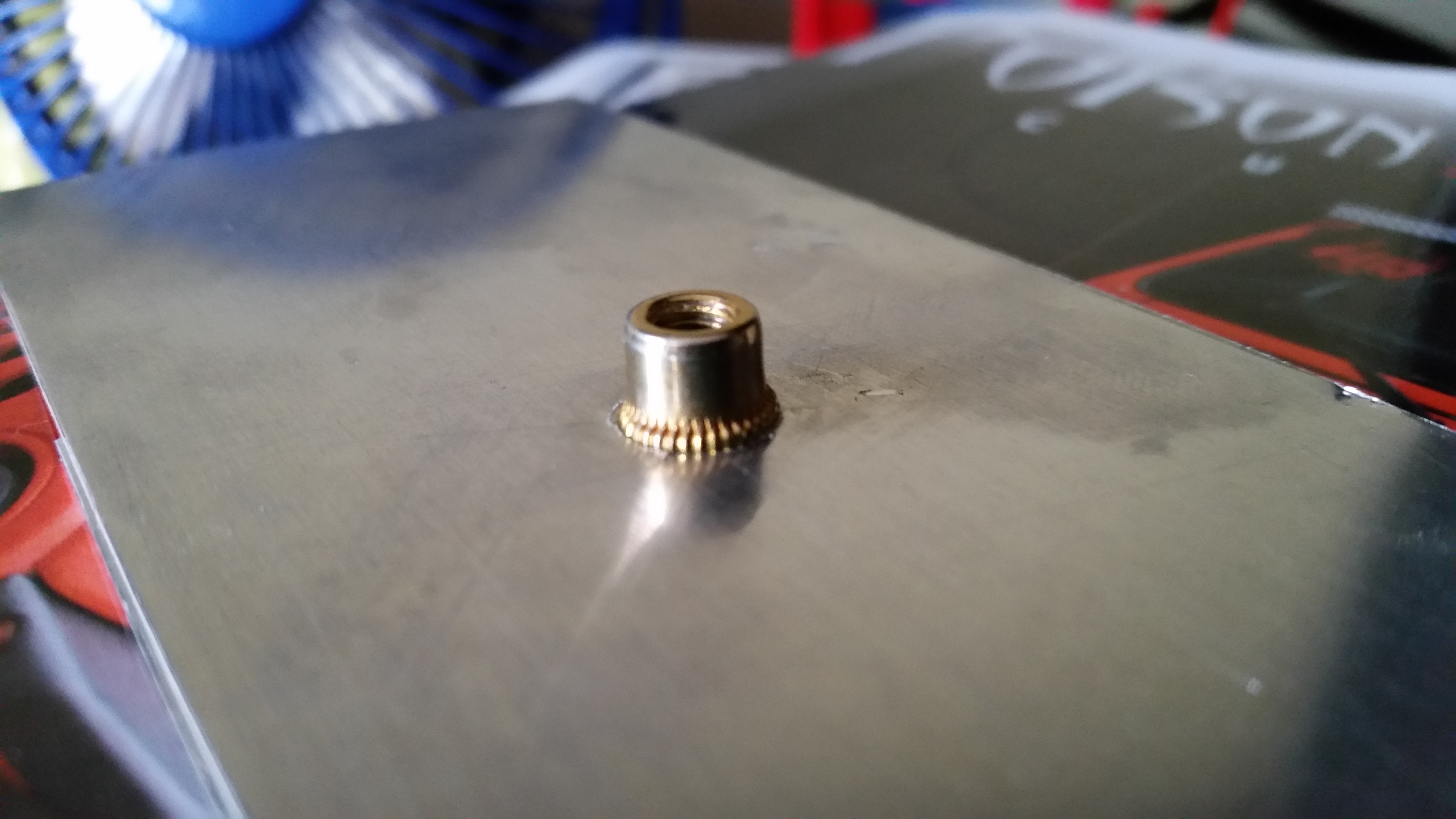

Some samples for your viewing pleasure.
Here is an example where the material is too thin where the nutsert is installed. The crimp was not able to grab onto the panel. The nutsert will spin.
This example shows a nutsert in a panel that is too thick. The nutsert could not properly expand because the mushroom could not form outside the hole. This nutsert may pull out of the panel.
This shows where a nutsert is installed in a hole that is not deburred. The nutsert did not install all the way and is not gripping the panel properly. This one will spin.
This is just right.
